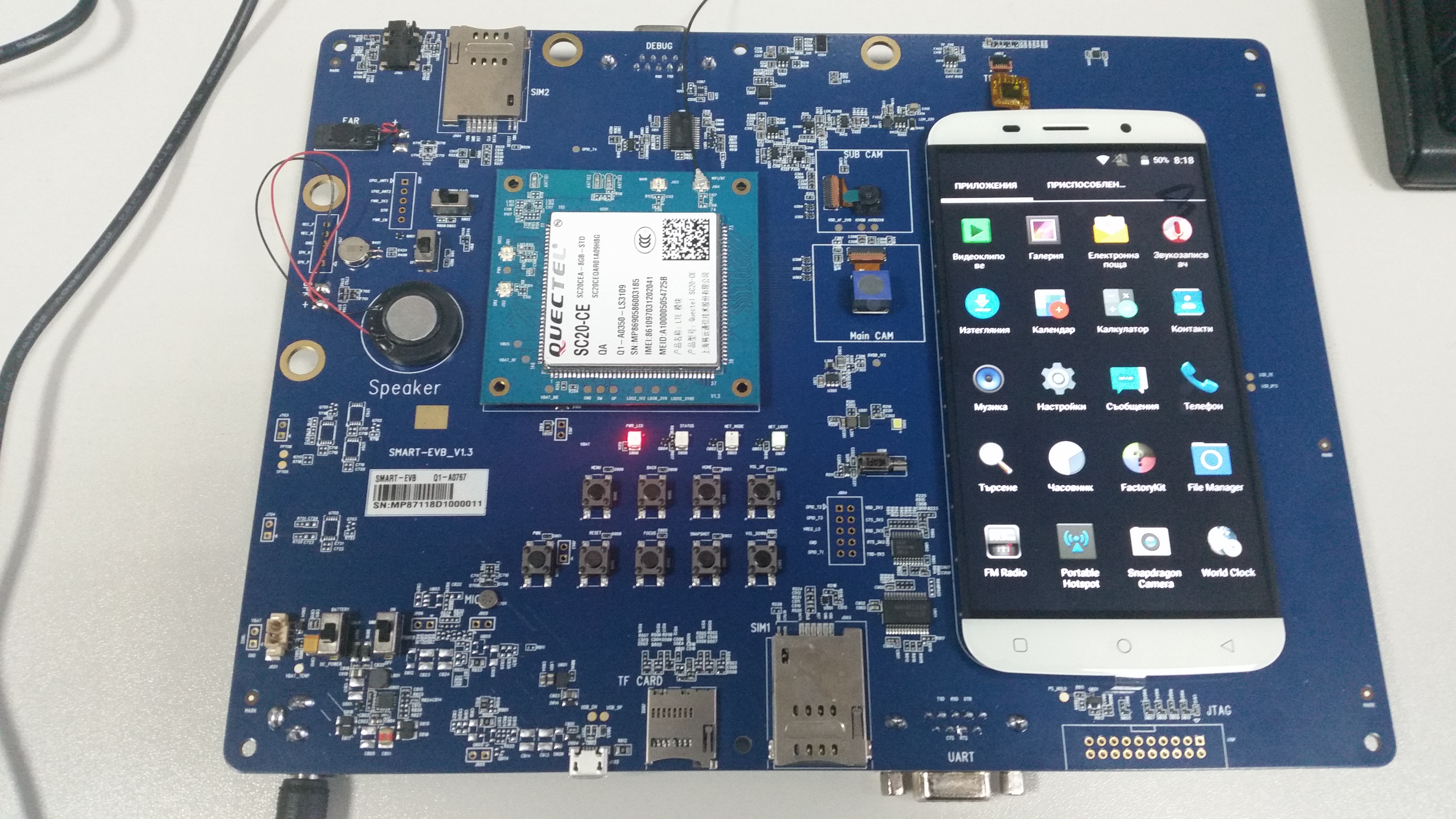

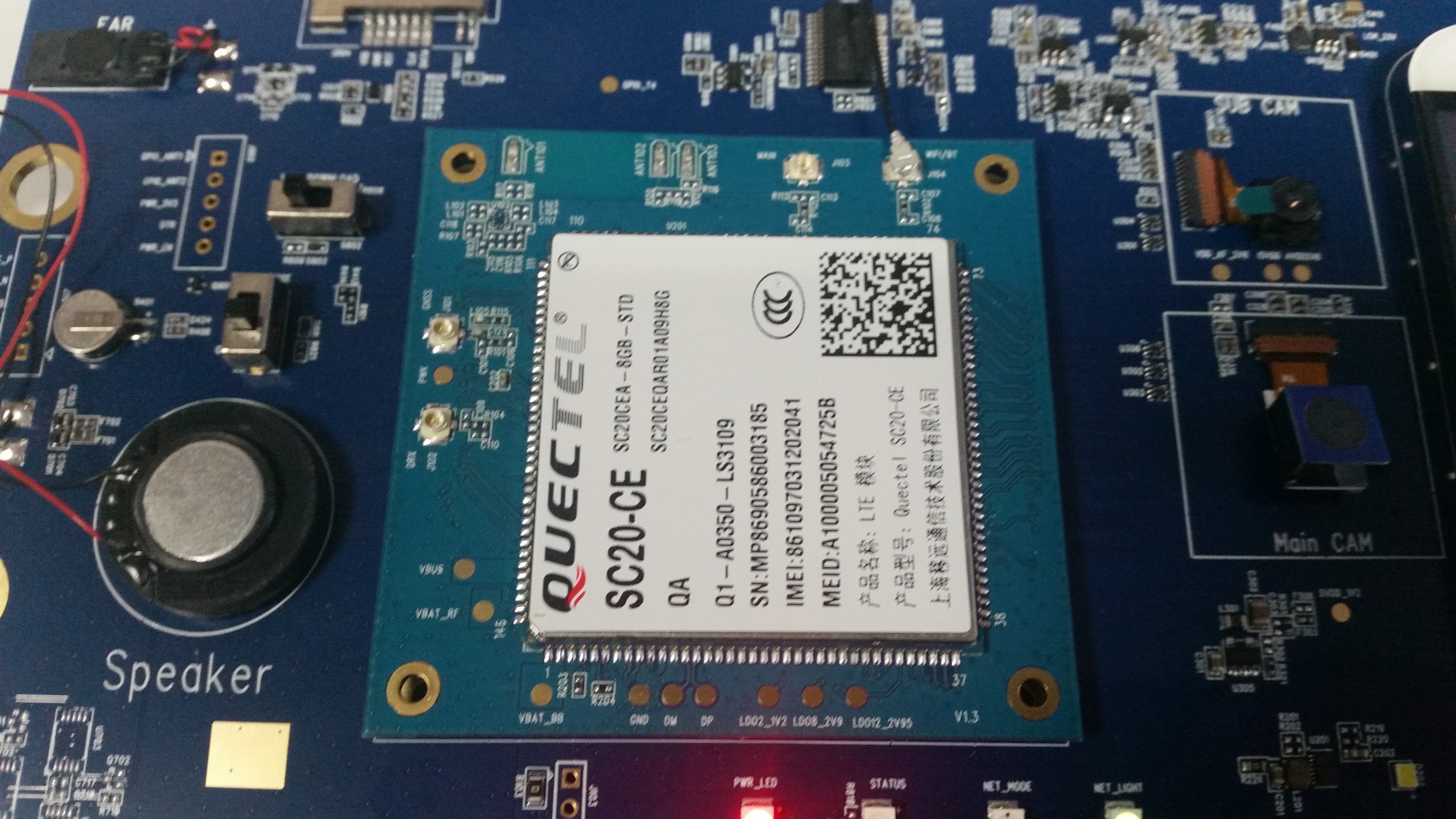

GSM Android модул
Мнения: 6094
Мнение GSM Android модул
Quectel SC20 -Multi-mode Smart LTE Module with Wi-Fi & Bluetooth
OS Android 5.1
SoC — Qualcomm quad-core 1.1 GHz
Flash - 8 Gb
Ram - 8 Gb
WLAN 2.4G, 802.11 b/g/n (SC20-CE)
2.4G/5.8G, 802.11 a/b/g/n (SC20-E/-A/-AU/-J)*
BT BT2.1+EDR/3.0/4.1 LE
GNSS GPS/GLONASS/BeiDou
LCM 4-lane MIPI_DSI, up to 1.5Gbps for each
HD (720P) @60fpbs
Camera Use MIPI_CSI, up to 1.5Gbps per lane
Support two cameras:
2-lane MIPI_CSI for rear camera, up to 8MP
1-lane MIPI_CSI for front camera, up to 2MP
Touch Panel Capacitive-screen
Audio MP3, AAC, AAC+, eAAC, AMR-NB, - WB, G.711,
WMA 9/10 Pro
Video Encode: 30fps 720P (H.264), 30fps WVGA (MPEG-4/VP8)
Decode: 30fps 1080P (H.264/MPEG-4/VP8/H.265
DivX4/5/6), 30fps WVGA (H.263)
USB 2.0 Device ×1, high Speed, 480Mbps
I2C ×3
USIM ×2, support 1.8/2.95V
GPIO ×25
UART ×2, high-speed UARTs
SDIO ×1, 3.0, 4bit SDIO
PWRKEY
Antenna 4 pads for Main Antenna, Diversity Antenna, GNSS Antenna
and Wi-Fi/BT Antenna, respectively
ADC ×3 (BAT_SNS, BAT_THERM, ADC)
Approval CCC/CE*/FCC*/GCF*/PTCRB*/AT&T*/ACMA RCM*/Verizon*
20170127_081840.jpg [ 4.44 MiB | Прегледано 5768 пъти ]
20170127_081826.jpg [ 4.84 MiB | Прегледано 5768 пъти ]

Мнение Re: GSM Android модул
Този Smart LTE модул може ли да работи с GSM операторите в Европа?
Пет Яну 27, 2017 5:30 pm
Мнения: 1391
SC20-CE - китайска версия
FDD LTE: B1/B3/B8
TDD LTE: B38/B39/B40/B41
TDSCDMA: B34/B39
EVDO/CDMA: BC0
WCDMA: B1/B8
GSM: 900/1800MHz
