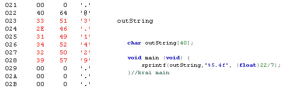

Уфффффф , 2 пъти изчетох ръководството на HI-TECH, ама трябвало и FAQ на сайта им да видя , да разбера защо така се получавало.
Why do my 'float' variables in MPLAB's Watch window have the wrong value?
MPLAB's Watch window interprets all floating-point variables
('float' or 'double') as 32 bit values unless you manually change
the properties for each one.
Since our PICC compiler uses 24 bits for 'float', and also for
'double' unless you explicitly specify otherwise, this means
all floating point values displayed will appear wrong.
To correct the display, right-click on the variable name in the
Watch window and select Properties, then change its size to 24 bits.
А това май е отговора на втория ми въпрос. Ама ще пробвам утре че сега излизам :)
Using %f in printf does not work
Q: I have a printf call like:
printf("number=%f\n");
but the output is 'number=(non-float printf)'. What am I doing wrong?
A: In HPD you must set "Options/Float formats in printf" or from the command
line use a -LF option to include the floating point library. The default
library does not include floating point support for printf, to reduce the
code size.
Благодаря още веднъж на всички :)
Все пак ще пробвам и вашите варианти :)
